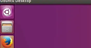

Close terminal and click on ubuntu icon on top left side
Type google and click on the google icon
