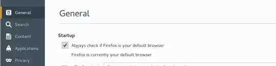

You can also change your default browser in the relevant browser settings - e.g.
Firefox:
Preferences, tick 'Always check if Firefox is your default browser'
Chromium:
Settings, click 'Make chrome default browser'
