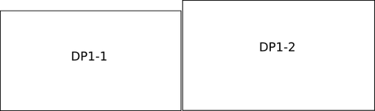

  • Could you describe how you'd like the screens arranged? Possible because of a bu, changing in in monitors (gui) doesn't work, but from cli we might work around. – Jacob Vlijm Jul 01 '16 at 10:37
  • @JacobVlijm Thank you form helping me so far! I'd like it to be so that 24'' is on the top left, 27'' is top right (these 2 bottoms aligned) and laptop in the bottom and center, hopefully I expressed myself clearly enough. – Silver Ringvee Jul 01 '16 at 10:40

Setting up your (complicated) monitor setup from cli
You mentioned the step above fixed the darkening screen(s), but you still cannot setup the screens in the layout you wanted (see below). That is possibly caused by a bug. We might very well be able to work around it by setting it up from cli.
To set up the screen layout as you described in a comment:
You'd need to run the xrandr command:
xrandr --output DP1-1 --pos 0x0 \
--output DP1-2 --pos 1920x0 \
--output DP1-1 --pos 0x360 \
--output eDP1 --pos 1440x1440
...if I made no typo or other mistake...
Explanation
Normally, in a complicated screen layout, you simply need to work from left to right, from top to bottom.
However
If you don't know for sure what is the current layout, you cannot place the first screen, other than 0x0. If there is empty space in the top of your screen layout, xrandr will remove the empty space and change e.g. 0x200 into 0x0. Therefore the steps need to be:
  1. position DP1-1 and DP1-2 horizontally top-alligned:
    xrandr --output DP1-1 --pos 0x0 --output DP1-2 --pos 1920x0
  2. only then bottom-align DP1-1 with DP1-2:
    xrandr --output DP1-1 --pos 0x360
  3. place eDP1 in the middle below the other two screens:
    xrandr --output eDP1 --pos 1440x1280
