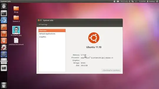

I've checked the System info that shows like : enter image description here
The graphics row shows itself as empty. SO I've presumed that the graphic drivers aren't detected and hence I went to Unity-> Additional Drivers and installed the fglrx driver that the UI has suggested.
Even after installing so, the graphics part in System info details shows nothing and still Unity 2D runs in spite of all the effort.
