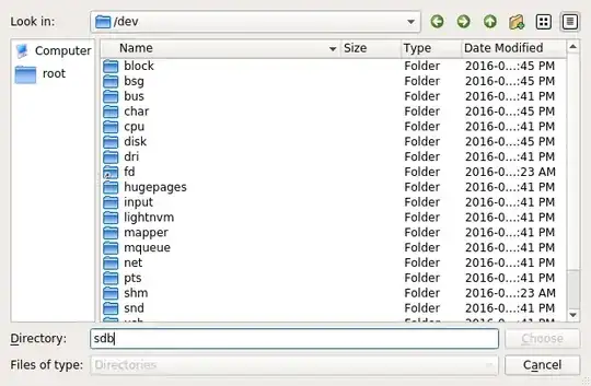

Running sudo fdisk -lu returns the hdd I want to mount as
Disk /dev/sdb
but when I try to mount it from KDE Partition Manager it doesn't show some directories when I try to set up a path (tried showing hidden folders, only displayed 3) and through the konsole with sudo mount /dev/sdb /mnt, I get
mount: wrong fs type, bad option, bad superblock on /dev/sdb,
   missing codepage or helper program, or other error

EDIT: Was able to find the /dev folder by clicking the bar next to "Look in" however the partitions don't show up even as hidden files but it does show up if I type it into the "Directory:" bar but its not selectable ("Choose" is greyed).
Gparted, as expected, no difference. I'm sure its a file type error..

    Usually you mount by the partition number on the drive. It should be `sudo mount /dev/sdb1 /mnt` meaning to mount the first partition to `/mnt` if that is what you're trying to mount. – Terrance Jul 20 '16 at 03:29
  • Its in /dev/ as just "sdb". Oh, I just want it under "Devices" in the file manager (under my SSD) – HelpMeee Jul 20 '16 at 03:52
    It needs a partition that's formatted to mount. Those show up as `/dev/sda1` or `/dev/sdb1` etc... – Terrance Jul 20 '16 at 03:58
  • Do you know how I would do that through KDE Partition Manager? I've uploaded a picture. Its telling me to create a new partition table; does it need to have at least four? I'm only using it for storage. – HelpMeee Jul 20 '16 at 04:11
  • Nevermind, its no longer asking me to create a partition table once I clicked "Apply", but the sudo command line to mount still gives the same error. – HelpMeee Jul 20 '16 at 04:20

/dev/sdb is the entire block device, you don't mount this.
You mount a partion that is on the device, example:
From the first image, it looks as if there are no partitions on the disk any way, or you have recently made some changes to the partiton table and the kernel is not aware of them, so it is best to run
sudo partprobe
after making changes to inform the kernel to take a look at the new partion table.
No need to reboot, just run partprobe.
