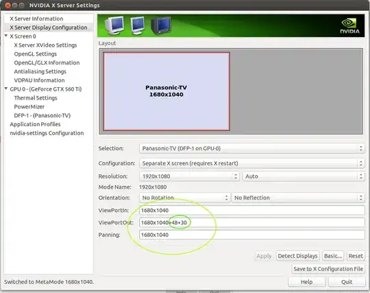

MANUALLY ADJUSTING THE RESOLUTION
If you happen to have one of the newest Nvidia Drivers, then some of the above points will not work. For this cases, Open the nvidia-settings app and go to X Server Display Configuration. Click on Advanced... and change the following options to a resolution slightly lower than the one you are using:
  • Video Port In
  • Video Port Out
  • Panning
Note that the TV I am using does not support 1680x1040. Instead I selected 1920x1080 ad then edited the 3 mentioned options to a slightly lower resolution so I could "move" the X/Y coordinates to see the Launcher Icons and Top Pane. In the Video Port Out option, The 2 values after the resolution are the X and Y coordinates. They will normally appear like 1680x1040+0+0 but after you edit the values and Save the changes you will see the Launcher and Top panel appear. In my case I put 48 for X and 30 for Y. This made the panel and Launcher correctly show in TV (Viewport).
