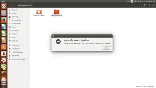

After setting up DSL connection using the following command
sudo pppoeconf
I can't access Windows PC from my networks. Before setting DSL, I could access the network, but now I can't and it shows me this message.
Can anyone help me?
