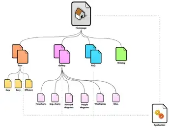

Which Open Source Tool can I use to create a website tree diagram using Ubuntu ?
I was looking in Dia but it is not that simple.
Something like this would be good :
Sitemap diagram
Thanks.
