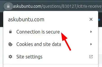

   1.b. Option from browser
  1. Open YOUR_SERVER_URL in Chrome.
  2. Click in the Lock icon to the right of the URL and then in the "certificate" link.
  3. Then click in the "Details" tab, and "Export" button.
  4. Save as YOUR_SERVER_CERT.pem and you won't need to convert it to pem file.
