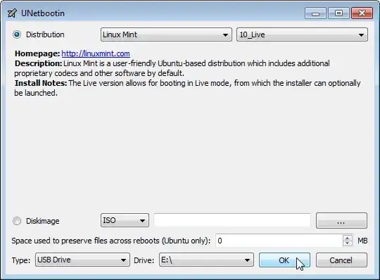

Look under UNetbootin:
unetbootin screenshot
In the bottom of the picture it says: "space used to preserve files across reboot (Ubuntu only)" you can see the number of Gb you want there.

  • unetbootin did not work at all for me on a macbook. mkusb works instead properly. – Luca Carlon Jul 29 '17 at 13:02
  • I would also not recommend UNetbootin in general. I have had it repeatedly fail to successfully create a live USB for 16.04, whether persistence mode or not. I have no idea if this is related to the version of Ubuntu, since it actually did work ONCE for me when creating a live USB for 14.04 on a really old, not particularly nice flash drive. The point is that in general I wouldn't recommend it: it worked ONCE out of 7 or so times. UNetbootin messed up a brand new flash drive almost beyond the point of repair--even mkusb couldn't rescue it, only chkdsk in Windows worked. – Hee Jin Apr 24 '18 at 17:12
