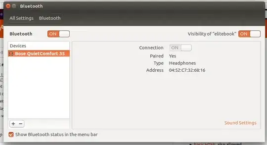

However, in the bluetooth GUI menu, it seems to think I'm paired with the device:
The headphones themselves never seem to recognise that the laptop is connected, and in my sound settings I don't see anything that I can output to, so the "pairing" is bogus I think.
