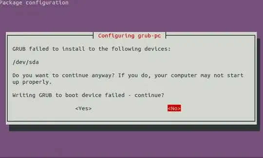

I'm trying to install Ubuntu to my Dell XPS. I have an existing Windows 10 install on it, which I'd prefer not to loose. I have an empty partition of about 400 Gb. However, Grub keeps failing to install. Also, the bootloader is appearantly broken now, as I can't boot from the hard disk at all at the moment.
What's I've done so far:
  1. I originally tried to install Ubuntu 16. It would always fail on the Grub install. After getting the error message and prompt with 3 options on how to proceed, the installer would crash. I read that Ubuntu 14 might get me around the issue.
  2. I booted from a Ubuntu 14 disk, and set it up to install Ubuntu 14 to the same partition that I had attempted to install Ubuntu 16 to. Grub still failed to install with the same error message. But, the installer didn't crash this time.
  3. I rebooted the machine from the Ubuntu 14 disk, loaded Ubuntu in live mode and ran boot-repair. It gave me several commands to run, but it still fails when it attempts to install Grub.
The error message I get now is:
Also, on the command line I saw these messages:
Installing for i386-pc platform.
grub-install: warning: attempt to read or write outside of disk `hostdisk//dev/sda'.
grub-install: error: embedding is not possible, but this is required for cross-disk install.
Boot-repair generated this diagnostics report: http://paste.ubuntu.com/23450135/

  • Your error says installing grub to sda, but Boot-Repair wants to install to mapper/isw_caeddgafgj_ARRAY0. And if BIOS RAID or "FakeRAID" you do install to the root of the mapper, not the drive. https://help.ubuntu.com/community/FakeRaidHowto Probably better to use 16.04 as that has all the older Dell Sputnik drivers/changes built in. – oldfred Nov 13 '16 at 22:50

  • a software-RAID (never a good idea)
  • with dual boot (a bad idea)
  • installed GRUB on one of the members of the software RAID (/dev/sda) bypassing the software RAID (a terrible idea),
so now you need to:
  • Restore the software RAID boot sector first by:
    • Restoring the boot sector from your backup.
      OR
    • Reading the manual of your Software RAID as you don't specify which it is, nor does boot-repair...
  • Install GRUB on /dev/mapper/isw_caeddgafgj_ARRAY0and not on /dev/sda

  • How do you know I'm using a software RAID from the information I posted? The system came from the store configured this way, so I honestly can't say if its hardware or software. However, the computer came with no manuals or documentation about a software RAID to my knowledge. On the other hand, it was 3 years and 2 countries ago, so its possible that said manual is just lost. – Nimrand Nov 15 '16 at 08:42
  • I'm *strongly* biased towards a **software RAID** because you didn't verify your BIOS and say that you have a hardware RAID. (people who don't know never had a hardware solution in my experience) **;-) :P** – Fabby Nov 15 '16 at 09:04
  • Based on oldfred's post above, I think it is a so-called "fakeRAID", if that makes any difference. The odd thing is that BIOS basically has no information about it except two options: one to switch between AHCI & SATA mode, and another option to enable/disable the ESATA port. I will try recovering the boot sector and see what happens. – Nimrand Nov 15 '16 at 11:38
  • your bias against Software Raid is not helpful here, it has many valuable uses and compares favourably with commerical solutions, i spent several years working in test on both. – Amias Nov 15 '16 at 11:54
  • I recovered the MBR by using microsoft's bootsect command from a Windows 10 installation CD. It boots into Windows again. However, installing GRUB to /dev/mapper/isw_caeddgafgj_ARRAY0 does not work. Every time I tried that option (before or after recovering the MBR), the Ubuntu installer seems to get stuck: as soon as I finish the last installation options screen it displays a message about installing to the HD, but the progress bar never progresses. – Nimrand Nov 16 '16 at 00:50
    After the fourth try, I finally got the boot loader to install to /dev/mapper/isw_caeddgafgj_ARRAY0. It boots to Ubuntu now. – Nimrand Nov 16 '16 at 12:02
