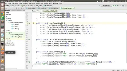

It's hard to explain this without a picture, so I'll add one. Basically, I installed IntelliJ IDEA using this PPA on 16.04. After installting, I found that typing "idea" in the standard program seach was turning up nothing, though the command intellij-idea-community was launching the program correctly.

And now, IDEA start showing up in search. So far so good.
I have an annoyance, though. Once IDEA starts up, the icon gets replaced by the ugly default question-mark thing (see the last icon in Unity):
Everything works fine. It's just that this icon is an eyesore. Also, if I lock this icon to launcher and then close IDEA and click on the icon to start the IDE, it doesn't. Instead, I just see a "busy" animation of this icon. To launch, I again have to type "idea" in the search and click on the png icon.
Any explanations for this?

What happened
intellij-idea-community installs a perfectly working .desktop file: /usr/share/applications/intellij-idea-community.desktop. Sometimes however, a freshly installed application needs a log out/in to show up in Dash.
This is apparently the case in your situation. I tried installing it with the same result. Simply log out/in did the job:
Your home-made launcher does start up the application, but does not connect to the window, so a generic icon shows up to represent the window.
How to fix
Remove your own made launcher from /usr/share/applications/intellij_idea.desktop, log out and back in.
important note
In any way, since you tried lock the (incorrect?) icon to the launcher, make sure to remove any Intellij IDEA - related .desktop file from ~/.local/share/applications, since possibly remaining .desktop files will overrule the global one.
