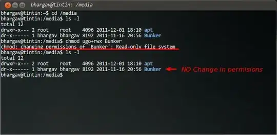

I have lost "Write" permission for myself, and all other permissions for 'Others' and 'Group' on my important NTFS Partition(Contains all my Data). Any amount of Chmod(ing) or using the GUI to set it right isn't working.
I get this error when doing it the GUI way.(No other details of why it couldn't set permissions is mentioned).
And this happens when doing it in CLI. This is quite an issue need help fast.

    As you can see, the problem is not permissions, but the 'read only file system'. Something might be wrong with the way you mounted it, or with the file system itself. Run `dmesg | tail` after mounting that partition to find out what's up. – mikewhatever Dec 08 '11 at 12:21

I got my answer on ubuntuforums.org
I was using the ntfs driver and not the ntfs-3g driver. I just needed to install the ntfs-3g driver and everything worked properly.
