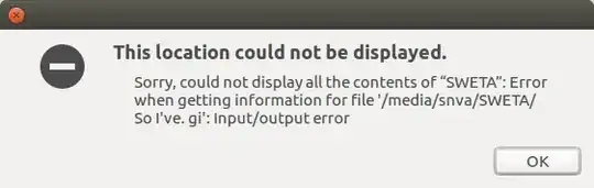

I recently deleted the Windows 10 from my HP Pavilion Laptop and installed Ubuntu 16.04.1 LTS using a pen drive. In another pen drive, I stored all the important data of Windows 10. But after installing Ubuntu, when I connected the USB to the port on my Laptop. It wasn't showing anything but the following window popped up.
Complete image of "Sorry, This location could not be displayed".
When I connected that pen-drive in another Ubuntu Laptop, I observed that many folders were converted into the binary files. However, I wasn't able to cut and paste those folders from pen drive to my desktop but was successful in copying a few of the folders. What should I do to get back my important data from USB?

  • Maybe it's an oversight of mine, but I can't find where you say what file system type is on the drive. Is it NTFS, FAT or exFAT? – Andrea Lazzarotto Dec 19 '16 at 14:37
  • @AndreaLazzarotto By using the mount command on Terminal, I found that it was written "type vfat" next to my USB location name. – KhiladiBhaiyya Dec 20 '16 at 09:17
  • Alright. Given that you can even at least mount it, the damage does not seem severe. After cloning it try to access the drive using TestDisk and report if it shows the contents. – Andrea Lazzarotto Dec 20 '16 at 12:27
