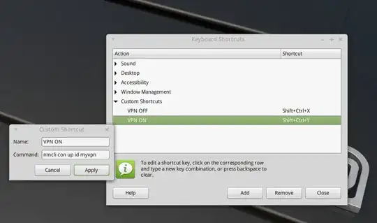

Is this possible? I want to have one Shortcut which works like a On/Off button for a VPN (similar to a wireless on/off Button on many laptops). To achieve this, I would probably need a script involving the network manager?
Reason: I have to connect and disconnect my VPN a lot. Every of these connects or disconnects takes three clicks, which adds up, plus my mouse is very insensitive (even in the most sensitive setting)
I have LM 18.1 Mate, with 4.8 Kernel.
11
I just found the solution, very straight forward.
Simply creating two shortcuts, with the commands below:
for VPN ON: nmcli con up servername
for VPN OFF: nmcli con down servername
