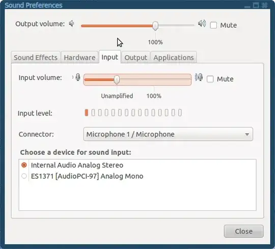

  2. You can see in the images that there are three options: "Headset", "Handsfree" and "Audio Sink". It does not seem to matter which one I click.
Here are screenshots with descriptions.
Available menu options in Bluetooth:
Persistent pausing in MPD. I can move forward or backward, but there is no "play" option:
VLC will happily play with no audio:
