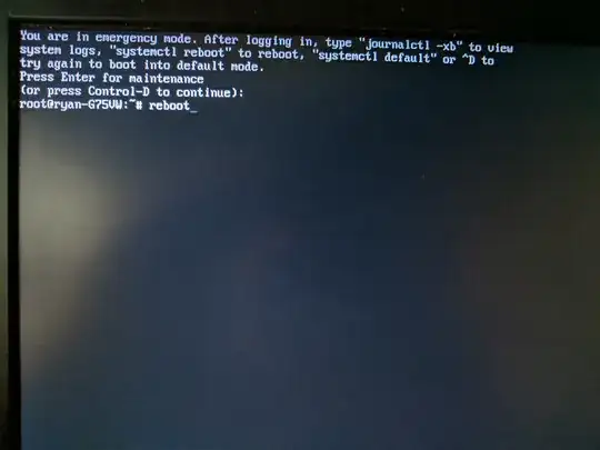

Whenever I turn on my laptop running Ubuntu 16.10, it always boots into Emergency Mode. The only way to get Ubuntu to start successfully is to boot into recovery mode, use dpkg to repair broken packages, and then to resume the normal boot sequence. Pushing CTRL + D just makes the Ubuntu splash screen flash, and then it goes back into Emergency Mode.
Here is the output of journalctl -xb: http://pastebin.com/CLJhR4Vf
Emergency Mode Prompt

Do the following and see if it works
  • Make a bootable USB/DVD and Boot into it.
  • After the load, open a terminal
  • type the commands
    sudo -i
    fdisk -l
    Fdisk will inform you as your partition / (root) called, say for example it is /dev/sdb1, continuous running:
    umount /dev/sdb1
    fsck -y /dev/sdb1
    reboot
  • Remove the DVD/USB and boot from the HDD/SDD (whichever is yours)
