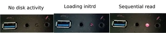

So I noticed something interesting about the HDD activity light. When loading the initrd, it's almost as if the light is being PWMed at a 10% duty cycle or something. This makes me wonder if GRUB's read is not optimized, maybe something like it's doing an OS call to read each byte rather than reading the image as a byte stream?

The disk activity light on my tower stays on for the entire 7 seconds...
