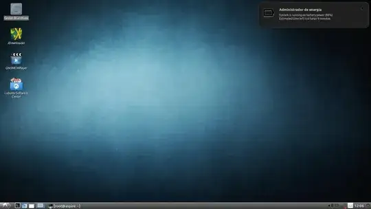

I want to see smaller pop-ups but where have I to go to configure this?
For example, when power manager pops up: I want a smaller notification
