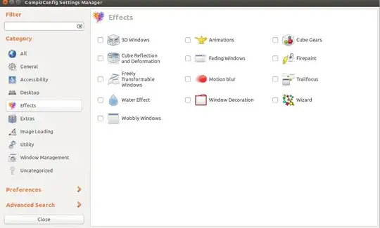

To fine tune Unity effects you can use compizconfig-settings-manager. If you don't already have it you can install it by first enabling the Universe Repository and then installing the package via either the software center or with the command sudo apt-get install compizconfig-settings-manager

Most of the heavier effects are handled by compiz Effects - Choose Effects from the right hand column and you should see something like this:
Effects
Unchecking all the boxes on this page should turn off unnecessary eye candy and result in reasonably good performance. You can of course experiment with other settings and evaluate the impact on performance on your particular system. Personally, I leave Animations and Fading Windows on as they don't seem to have a major impact on performance on my hardware, but turning them off does have a positive impact on performance.
