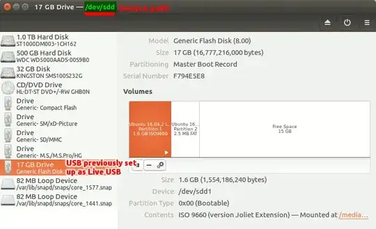

I've had this same issue with recent versions of Ubuntu when creating Live USBs. If your issue is the same as mine, the fix I have implemented is a very simple one. The issue seems to be related to the file system dumped onto the USB when you create an Ubuntu Startup Disk. Wiping the very beginning of the USB device erases whatever causes this problem.
Here's what you want to do.
  • Determine the path to your device, not the partition path. Mine is /dev/sdd. The device path will never end with a number! Numbers indicate partitions on the device. The device path should look something like /dev/sdX, where X is a letter a-z. Use the gnome-disks tool, select your device, and look at the window title.disks.png
  • Make sure none of the partitions on your USB device are mounted.
  • Armed with your device path run the following command, replacing /your/device with your device path (WARNING: this will destroy existing data on the device you provide the path for)
    sudo dd if=/dev/zero of=/your/device bs=1M count=10
  • Finally, now try reformatting your USB, and it should be back to normal
