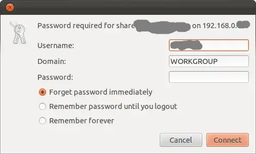

I refer to this picture in one of the comments below. It is not directly related to the formulation of my initial question but to a solution presented below by @lumbric in the comments.

  • Yes, `smb://127.0.0.1/` works fine now. A reboot seemed to solve (almost) all problems. Now I can access the Notebook by SSH and by `smb://192.168.0.*`. But the latter asks me for a password and then revokes the correct password. It wants a workgroup entry too which is `WORKGROUP` by default. If you have a hint why it does not want to take my credentials it would be nice. But since ssh works there is no priority anymore to solve this except for another user running into the same issue. Thanks in advance for our effort so far. – Aufwind Dec 25 '11 at 19:20
  • Samba passwords and system passwords do not match necessarily. Try out `smbpasswd`! – lumbric Dec 25 '11 at 19:27
  • You mean my login name and `smbpasswd` as password in the picture I added to my question above? – Aufwind Dec 25 '11 at 19:48
  • A sorry, that was not clear. There are two passwords. You can change the system password by using the command line tool `passwd` and the Sambapassword by using the command line tool `smbpasswd`. I think unless you change them they should be the same, but who knows... You will have to enter your Samba password if you want to connect through `smb://...` – lumbric Dec 25 '11 at 19:55
