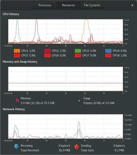

Each time gnome hangs there is a short peak of CPU usage and this is logged.
gnome-shell[10821]: pushModal: invocation of begin_modal failed

Update:
