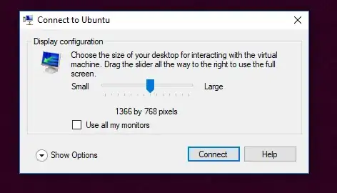

  • From a Powershell window opened as admin, execute the following command
    Set-VM -VMName <ubuntu-vm-name>  -EnhancedSessionTransportType HvSocket
(Replace <ubuntu-vm-name> with the name of your virtual machine running Ubuntu.)
If all went fine, when you restart the Ubuntu virtual machine, you will see the following window.
screenshot
Clicking on Show Options will give you more share options, for example the one for sharing the clipboard (guest to host, and vice versa), or for sharing the printer.
screenshot
You will be also able to save the settings for future connections to the same virtual machine, but in that case you will not be able to see that window again. I clicked on Save my settings for future connections to this virtual machine by mistake, and I had to change name to the virtual machine, and execute Set-VM -VMName <ubuntu-vm-name> -EnhancedSessionTransportType HvSocket again, to see the settings window.
