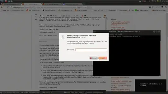

To be safe back it up using cp /etc/dhcp/dhcpd.config /$HOME/dhcpd.config.backup and run gksu gedit /etc/dhcp/dhcpd.config
Replace gedit with the editor of your choice
you will get a prompt like this
password prompt
Enter your password here.
A new window opens and you can edit your config there.
In case something goes wrong you can restore it from your backup in the home folder.
