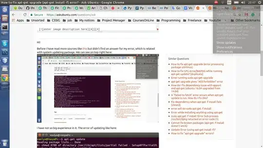

Before I have read more sources like this but didn't find an answer for my error, which is related with system updating package. We can see on top right here:
I have not so big experience in it. The error of updating like here:
proposes me to execute:

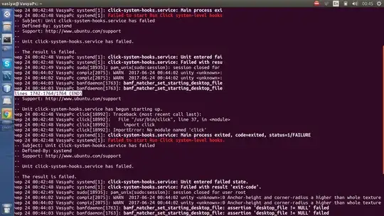

When I execute the command:
journalctl -xe
I have: enter image description here It seems like I need to install click.
