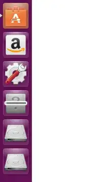

I'm trying to install steam but when i click the steam installer "install" button nothing happens. After a couple of tries this appeared and it stayed this way all night.
↑4th icon down
