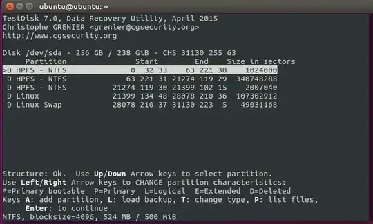

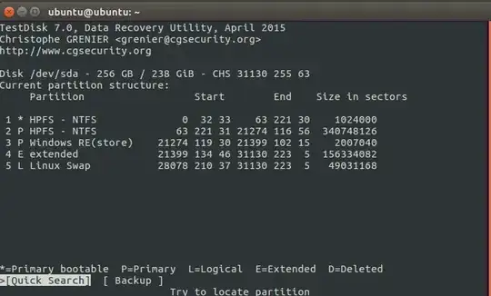

UPDATE 2 Now going through testdisk, here's the latest output enter image description here
http://paste.ubuntu.com/25572230/
UPDATE 3 Performed the quick scan, my files are seemingly there.. but when I do the deep scan I get this warning
Leaving everything marked for deletion.. in my experience I need to select the partition with the boot file in the root dir to be bootable, and unmark for deletion all the rest...

  • Back up existing partitions, just in case you make a mistake. `sudo sfdisk -d /dev/sda > PT_sda.txt` Copy to another device/drive. Testdisk is showing multiple Linux partitions (you may have resized several times.). But it looks like your last screen shows all your partitions including the missing Linux one? I would not keep D on all the others. Others have said parted rescue is easier as it is using sectors. http://askubuntu.com/questions/665445/upgraded-to-windows-10-on-dual-boot-and-cant-boot-to-ubuntu-partition/665462 – oldfred Sep 19 '17 at 15:12

Windows 10 Anniversary Update, and the more recent Windows 10 Creators Update, have a really bad habit of wiping out Linux partitions on MBR disks. Sounds like you're a victim.
Recovery is possible, but it can be tricky.
Boot to the Ubuntu Live DVD/USB.
Open Software & Updates and make sure that all of your software repositories are enabled.
In terminal...
sudo apt-get update # update the software database
sudo apt-get install testdisk # install testdisk
man testdisk # read the manual
sudo testdisk # start testdisk
You can also get specific instructions here: http://www.cgsecurity.org/wiki/TestDisk_Step_By_Step

  • All my partitions seem listed in this tool.. I'm trying to figure out how to recovery properly.. guessing in the link you sent I need section `11 Partition table recovery` ? – Erik Sep 19 '17 at 13:13
    @Erik follow the example at the web site that I reference. First you try to discover where your Linux partition USED to be, then you manipulate the partition table to restore the proper values so that the partition is returned to its original state. It's not easy. There's no real way to walk you through the process. But the web site is the best resource that I've found :-) Oh, I see you've updated your question... let me look at it... – heynnema Sep 19 '17 at 13:21
    @Erik see partition 4? It's an "extended" partition that used to contain two "logical" partitions... your Ubuntu partition and a swap partition. What's missing between partitions 4 and 5 is your Ubuntu partition. That's what you need to recover. The display seems to be showing the start/end in CHS (cylinder/head/sector) format, which is outdated, and which makes it difficult. You really need to see it in sector format. In testdisk, you'll want to see if there's a pref, or some such, to show the start/end in sector format. – heynnema Sep 19 '17 at 13:28
  • The deep scan didn't find anything new, but all drives are now marked as unrecoverable. In my experience.. I need to keep my partitions, but mark one of them to boot to.. but it feels I may be in over my head here. Might just hand this back to IT – Erik Sep 19 '17 at 13:40
    @Erik yes, it requires a healthy knowledge of disk partition structure. Thankfully I've never actually had to do it myself on my own disk. – heynnema Sep 19 '17 at 13:48
  • I wish testdisk would update to sectors. Testdisk uses CHS - formula for conversion to LBA http://en.wikipedia.org/wiki/Cylinder-head-sector – oldfred Sep 19 '17 at 15:07
