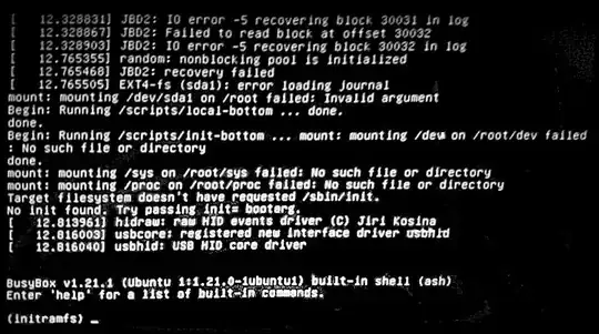

fsck /dev/sda1  -->/bin/bash: Output: not found

  • Follow my answer [at this issue](https://askubuntu.com/questions/947407/partial-upgrade-to-16-04-3-lts-error-cannot-create-wakeup/947521#947521), see if it works. – Redbob Oct 14 '17 at 12:43
    boot from a livecd, and paste the contents of et/fstab in your question. your root file system should be mounting as "/" not "/root" – ravery Oct 14 '17 at 12:56
Remove HDD from system connect it to another system on second SATA port alongside with that HDD and turn ON system
Open terminal
Find the device label of that HDD using
sudo lsblk
for example if it is /dev/sda1 then run below command in terminal
If fsck is not working then try
sudo e2fsck -f -b 32768 -y /dev/sda1
