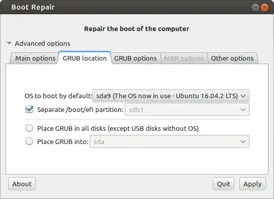

  1. Start Boot-Repair, and select Advanced options -> GRUB location tab.
  2. If you do not see a Separate /boot/efi partition option, this means that your PC does not have any UEFI partition.
  3. If you see a Separate /boot/efi partition option, put a checkmark in the checkbox to the left of it.
  4. Click the Apply button in the lower right corner.

  • If Ubuntu is installed on a GPT disk (you can check it via the sudo parted -l command), use GParted partition editor to create a BIOS-Boot partition (1MB, unformatted filesystem, bios_grub flag) at the start of its disk.
  • Start Boot-Repair, and select Advanced options -> GRUB location tab.
  • Uncheck the Separate /boot/efi partition option
  • Click the Apply button in the lower right corner.
