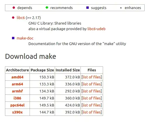

The second alternative, often the one week option, is to go here: https://packages.ubuntu.com/ Select artful, the code name for Ubuntu 17.10. Find the missing packages, in your case, linux-libc-dev, make, build-essential and dpkg-dev. Be certain to also download the dependencies of the dependencies. For instance, as you see by the red dot, make depends on libc6.
You can check to see if it is already installed with:
sudo dpkg -s libc6
On my system, it is already installed, so I see:
Package: libc6
Status: install ok installed
Be sure to download either the 32- or 64-bit version as needed. Find out with the terminal command:
arch
If it returns x86_64, then you need the 64-bit versions of these packages, also known as amd64.
Transfer all these on a USB key or similar and install them all as you did previously:
sudo dpkg -i *.deb
If there are still more missing dependencies, go back and try again.
