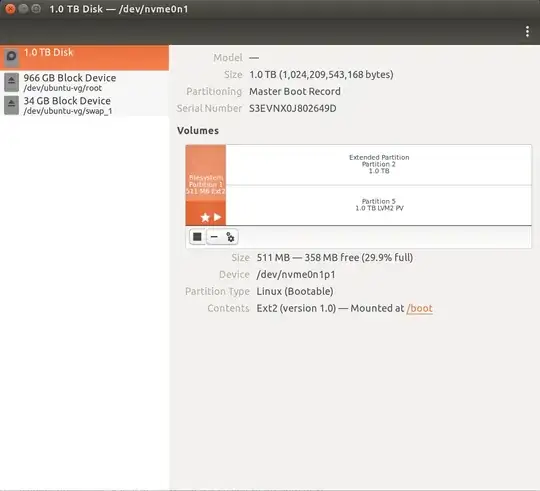

I currently have Ubuntu 16.04.2 installed on my laptop, and I would like to dual-boot with Windows. How would I go about doing that? If it helps, here is a screenshot of my hard drive listed in Disks.
1.0 TB Disk -- /dev/nvme0n1

    If you have the chance its, in general, easier to install Windows first and then Ubuntu. – M. Becerra Jan 22 '18 at 13:40
    @M.Becerra: [not necessarily for an UEFI system](https://askubuntu.com/a/666632/3940) – Takkat Jan 22 '18 at 13:43
    @M.Becerra Yes I know that, but I would rather not have to re-install Ubuntu. – Curtice Gough Jan 22 '18 at 13:48
  • The above considers UEFI installation, the one you should have done from the start with Ubuntu (also the recommended mode for any Windows 8 or newer). But instead you installed Ubuntu in Legacy mode. It will be much easier to install both in the recommended method. As it is now you'll have an hard time making room for Windows and then reinstalling Grub. –  Jan 22 '18 at 13:54
