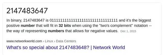

There are many theories on this, but I'm inclined to believe that Satoshi wanted to pick the maximum number allowed in 32-bit (which is 2147483647); however Satoshi admitted in an e-mail to Mike Hearn that the value was somewhat arbitrary as well.
Below is a visual of that 32-bit int max.

4That number (max 32-bit) is 2.1 billion, not 21 million. I'm not sure I follow your reasoning here. – chytrik Dec 18 '20 at 21:08
