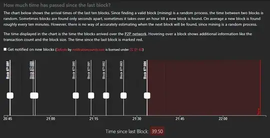

If Joe sends Sue a satoshi, it will be at least 9 minutes and 59 seconds until they get 1 confirmation (as I understand it).
This is not true. There is no fixed time interval between two blocks. You might see several blocks in a few minutes or no blocks for an hour. On average if looking at a bigger time frame, the block interval is ~10 minutes because of difficulty adjustments.
