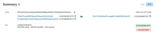

Clarification 1: (ignoring the fee and change) Suppose Alice sends me (Bob!) 2 btc. She got these 2 btc as a result of Larry and Greg each sending her 1 btc. This means she has these two UTXO outputs each for 1 btc associated to her wallet, and when she sends them to me the transaction will have 2 inputs and 1 output, kind of like this transaction I found on a block explorer.
