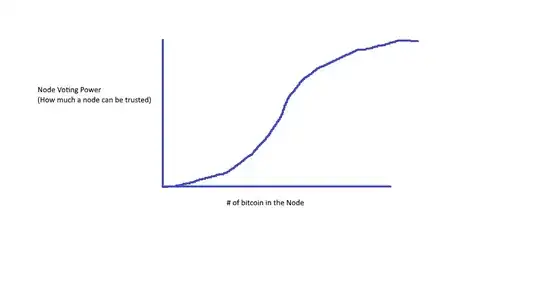

There has to be consequence to the attacker, large enough for him to feel the blow of his own attack.
To create the consequence for him: The voter (trusted Node/Full Node) has to have bitcoin, and the more bitcoin the node has, the more voting power (more trusted they are). Example, if the attacker really wants to kill the whole bitcoin network, he has to have at least 51% of bitcoin in circulation. If a bitcoin network is worth $100 billion. He has to buy $50 billion worth of it. Try killing the network and he will lose his $50 billion. Yes, others will lose some little value, but he'll lose much more value, and we can start another cryptocurrency.
It doesn't have to be a linear 1 bitcoin = 1 voting power. It can be a function. like voting power = root2(bitcoin), or other functions.
The only problem with this is that most people will use a centralized node (because they're either using a light node and do not want to waste resources for full node), so their voting power may be centralized somewhere and can be used by the attacker to attack (assuming that more bitcoin = more voting power). The solution to this is probably applying a slowing function (like the root function) to limit their voting power. But then the attacker may use many small value wallet to undermine the big centralized wallet. (Everything in moderation tactic, too much or too little is not good) So we should as well lower the voting power of those who has very little bitcoin in their node - see picture.
So what happens to the node that doesn't have a bitcoin? It's going to be useless anyway because they will leech from the network. I'd say to assign no bandwidth and voting power at all to them since they're not using bitcoin anyway and only wasting network resources. perhaps let them be a low priority reference, just to make them a bit useful.
Same goes to the miners. we should assign similar function as in the picture. We don't want big miners to make the network centralized and in the end having too much power to ruin the network. Since the bitcoin community is by the people and for the people; That is the point of the whole decentralization thing, isn't it? So that we don't get bullied by the big power who wants to centralize everything. We definitely should limit the big power, as well as the useless people who don't use bitcoin and leeching from the network and slowing the real community as a whole.
See the picture below: Node Voting Power
Can this help dealing with the DDOS attack as well?
