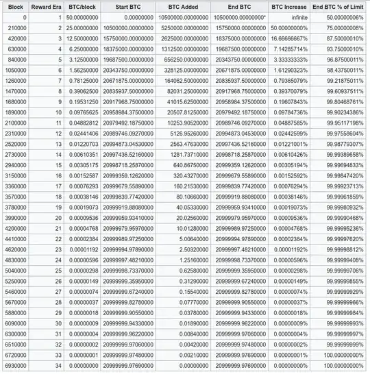

On the Bitcoin wiki ( https://en.bitcoin.it/wiki/Controlled_supply ) you find this table that tell you when and how each of the 33 halving process will happen:
If you need a technical explanation of how the halving work in the code here you find a dissemination about it: https://ma.ttias.be/dissecting-code-bitcoin-halving/
Keep in mind that the halving are programmed by block height, so there are only estimates on which date these blocks will be reached (and the block subsidy will cut in half), but all other info on this topic are exact and well documented.
