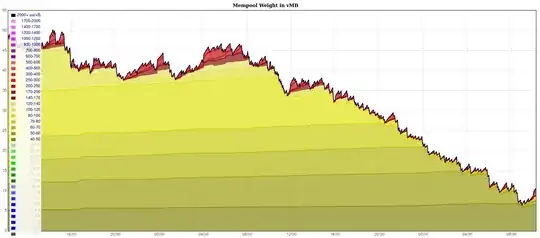

Going out on a limb here, but I would guess that your node is not running 24/7.
Full nodes only rebroadcast transactions once when they first hear about them. If your node is only online intermittently, it would only hear about new transactions getting submitted to the network. However, each node builds its block templates from the mempool that it locally maintains.
enter image description here via jochen-hoenicke.de
Especially in the past day, where blocks were mostly clearing transactions broadcast much earlier, your node would not be aware of the majority of the transactions mining nodes were tracking in their mempools and including in their blocks. Your node would only learn about most of the transactions as blocks get found and announced.
This is substantiated by your block template only collecting ₿7.45954254 in mining reward, whereas the block you link to collected an additional ₿1.68 in fees for a total reward of ₿9.14729350, i.e. the miner was simply aware of more valuable transactions to include in their block than you.
