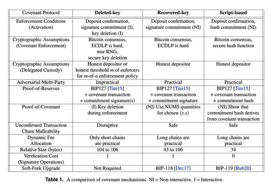

The solitary paper that has compared building vaults using OP_CHECKTEMPLATEVERIFY and SIGHASH_ANYPREVOUT at the time of writing is Bitcoin Covenants: Three Ways to Control the Future.
This paper discussed three categories of vault design: deleted key (no consensus changes required but inferior security model), recovered key (requires BIP 118 consensus change, superior security model) and script based (requires BIP 119 consensus change, superior security model).
It stated:
Recovered-key and script-based covenants are mostly functionally equivalent and so the advantages that recovered-key covenants have over deleted-key covenants also applies to Script-based covenants. If either were enabled by their required soft-fork upgrade then a new domain of practical covenant-based protocols could emerge. Understanding precisely what utility is gained from such upgrades is key to their progress.
