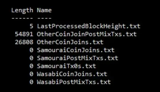

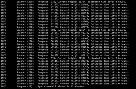

Dumplings/Dumplings/Constants.csand make the following changes:FirstJoinMarketBlock=1 FirstWasabiBlock=1 FirstSamouraiBlock=1 FirstWasabiNoCoordAddressBlock=1 ApproximateWasabiBaseDenomination = Money.Coins(0.001m) WasabiBaseDenominationPrecision = Money.Coins(0.0002m);Run dumplings
bitcoind -signet=1 -txindex=1 -server=1 -rpcport=8332 -rpcuser=user -rpcpassword=password -rpcworkqueue=128 dotnet run -- sync --rpcuser=user --rpcpassword=passwordAfter scanning is finished you will see some transactions in scanner directory. There was no wasabi transaction for me although you will find 1 which was created in the end.

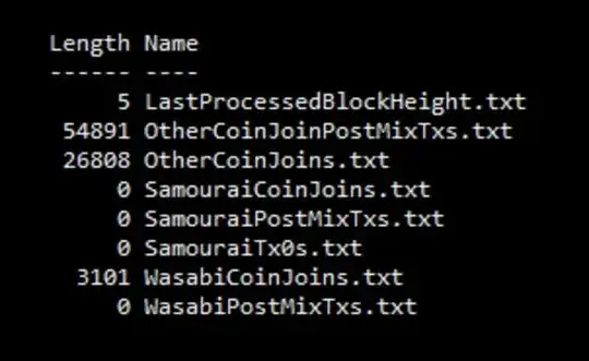

c4f506516ef68c3b3daf71fda5383978b1dca0a85db436b9e731da3b0aef8f19Check fake wasabi coinjoin in dumplings
dotnet run -- resync --rpcuser=user --rpcpassword=passwordCheck the transaction in explorers that support signet: https://mempool.space/signet/tx/c4f506516ef68c3b3daf71fda5383978b1dca0a85db436b9e731da3b0aef8f19
