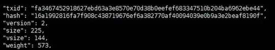

there's a transaction txid is fa3467452918627ebd63a3e8570e70d38b0eefef683347510b204ba6962ebe44, using bitcoin-cli we can see it's size,vsize and weight
we can get it's hex and it's accurately 225. using the formula vsize=(weight+4-1)/4=576/4=144,there's no problem
but when calculating the vsize bytes,it should be (573-225)/3=116,but the witness data in this transaction is enter image description here
when i delete txinwitness hex data(selected in the following picture) from origin hex(225 bytes),i can't get the result 116.Where is wrong?Can anyone tell me how to calculate?much thanks. enter image description here

  • In your second calculation, what are you trying to calculate? The first calculation is the correct way to calculate vsize. Whatever you are doing in the second completely ignores the witness which is incorrect for vsize calculation. – Andrew Chow Jul 07 '22 at 03:54
  • https://bitcoin.stackexchange.com/questions/80325/calculating-the-witness-size-of-a-transaction?r=SearchResults like this question's example,i 'd like to calculate the base bytes.according to this posts,weight=3*base_bytes+total_bytes.now weight is 576,total bytes is 225,the base_bytes should be 116,and i wonder where is the 116 base bytes in the total hax 255byes? – noob Jul 07 '22 at 05:02
  • or i can simplify my question.If I only know the transaction's origin hex 225 bytes.How to calculate the weight and vsize? – noob Jul 07 '22 at 05:08
It is not possible to calculate the size, weight, or vsize, purely from the JSON decoding of the transaction as the JSON decoding does not output the hex values of various counters, as well as the segwit marker and flag bytes. If you try to reconstruct the transaction with only the information that is output, you will end up with a total size that is less than it's actual size.
In your example, the transaction hex is
020000000001017fb11165fc5a6edf3bf06176c8915b22e20c3c48966d1d5c5673d4bc76a98c6e0100000000fdffffff024a140000000000001976a9145e3a929c6f941ad02c352b47d33a65bd160afe2f88accc8c0700000000001600149aba0ec86126b94b4dfdff48c4855ec49975c8e50247304402200615b90428b7e857d074ef17da69d5d533adc2c02fb739b04ecb88e38723afcd0220070f30781a8020ba0330a96b2a58358c5b5073ed391cee50ea1650e3972fcb0d012102030df0337a88e6f5c77f593eeb8b9d425742fbee78a4dcfeb66f90dec8e30bf25d560b00

So the base size comes out to be 116, the total size is 225. The weight is 3 * 116 + 225 = 573.
The vsize calculated from the weight is (573 + 4 - 1) / 4 = 144. Calculating the vsize from the sizes is ceil(116 + (225 - 116) / 4) = 144.
