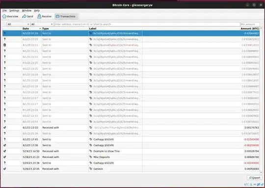

I engaged in Bitcoin transactions as the sender; trying to send some Bitcoin to my CashApp so I could sell it and pay a few bills. On 05/26/23 at 23:38 I engaged in the following as the sender:
Status: 0/unconfirmed, in memory pool

After doing some research, I came to the conclusion that I would need to create a Child-pays-parent-fees (herein, CFPF) transaction or use an accelerator service such as this: ViaBTC|Transaction Accelerator. Here is my initial Reddit post where I asked for help and obtained the conclusions I would have to either do CFPF
I am not sure at all how I would go about doing a CPFP transaction. I found this also on Reddit explaining a high-level-overview of what needs to be done; however, if possible I would appreciate a more detailed response as this would be my first ever CPFP transaction. I am not in a dire hurry to get these funds, its not life or death, but I would like to have the Bitcoin within a few months.
Also, here is the text of a few other transactions I have made after the initial one on 05/26/23 that may impact this. Again, I am not sure at all, but here is all the information I have and was able to research.

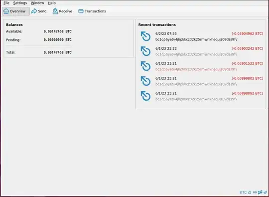

PLEASE NOTE that some of the transactions (the ones I've bumped) have RBF enabled and are not going through, I believe this has something to do with my question; but I'm not sure. I've included a screenshot of my transactions tab in Bitcoin Core.
Here is the text export of my transaction list

Transaction total size: 666 bytes
Transaction virtual size: 344 bytes
Output index: 0
Status: 0/unconfirmed, not in memory pool
Date: 6/1/23 23:20
To: bc1q56yetv4jhpkkcz32k25rmwnkhequjz09dss9fv bc1q56yetv4jhpkkcz32k25rmwnkhequjz09dss9fv
Debit: -0.03860850 BTC
Transaction fee: -0.00033792 BTC
Net amount: -0.03894642 BTC
Transaction ID: 942ccd245c1f4c5f5b8737248a4440715899dc86eb8f83492a134bb8a3027833
Output index: 1
Date: 6/1/23 23:20
Transaction fee: -0.00035512 BTC
Net amount: -0.03896362 BTC
Transaction ID: 5bb477069e2af33f3e6961e5c66a43accabaa4ac8c0cb099a6d7ce2d56ca7982
Output index: 1
Date: 6/1/23 23:21
Transaction fee: -0.00037232 BTC
Net amount: -0.03898082 BTC
Transaction ID: c1cb3d86bac5ef374199302fb1f234b8ce6b47bb7f155c802337a9f6e4f4603f
Output index: 1
Date: 6/1/23 23:21
Transaction fee: -0.00038952 BTC
Net amount: -0.03899802 BTC
Transaction ID: 730d52624571f180e9c437a41c3ea2de23b541ddd4993022b6f94138a39e7fd0
Output index: 1
Status: 0/unconfirmed, not in memory pool, abandoned
Date: 6/1/23 23:21
Transaction fee: -0.00040672 BTC
Net amount: -0.03901522 BTC
Transaction ID: 0b6ccd522bbb89f62ea044b74595be1d2608e070561ae6f8f05a98d8a22779cc
Output index: 1
Date: 6/1/23 23:22
Transaction fee: -0.00042392 BTC
Net amount: -0.03903242 BTC
Transaction ID: ba7d2617a4d26c7e40cab9aedbb4158d78a276aae0a1d6329d5fbadae1fb10b7
Output index: 0
Date: 6/2/23 07:55
Transaction fee: -0.00044112 BTC
Net amount: -0.03904962 BTC
Transaction ID: 1014e8ca82ada04e15f21fc6d0e1e6a7fdaf00a0dab09730251c382fa59f532f
Output index: 0
