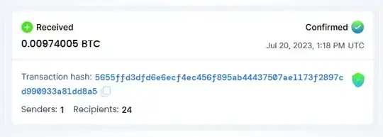

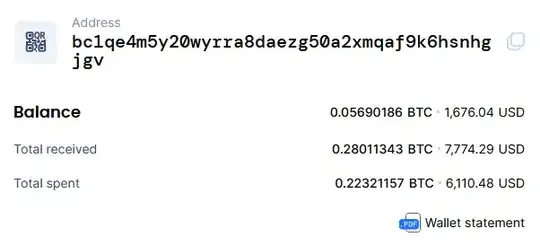

There are 24 recipients because coinbase has batched together transactions from several of its customers.
One of those recipients is address bc1qe4m5y20wyrra8daezg50a2xmqaf9k6hsnhgjgv which can be seen at a blockchain explorer as having received 0.00974005BTC in that transaction.
explorer address total
explorer address transaction
So the recipient has absolutely definitely received the money. They have control over it, not anyone else.
