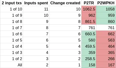

The below table shows the total weight of transactions under the assumption that most of them are single-input and creating change, created using either P2TR or P2WPKH outputs, and one of X transactions having a two inputs instead of one:
Table that compares total weights for
If only one out of seven transactions uses two inputs and you always create change, you’ll be able to save up to 1.5% by sticking to P2WPKH.
If 1 out of 6 transactions has at least two inputs or if you can sometimes avoid creating change, your total transaction weight would end up being lower if you use P2TR.

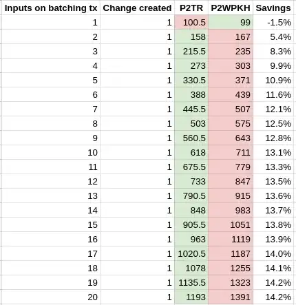

Batching
Whenever you use more inputs than you send outputs to yourself (e.g. when you make big transactions for batching payments, consolidation transactions, the payments you receive are smaller than the ones you make), or you’re able to avoid change altogether, it will be cheaper to use P2TR:

Exchange/Brokerage
If you give out P2TR deposit addresses, your customers pay for the larger outputs, and you have less cost when you spend those deposits. Most exchanges and brokerages batch withdrawals. Batched payment transactions will often have multiple inputs, but only require a single change output to facilitate many withdrawals. When you consolidate leftover small inputs, you do so at opportune moments with low feerates, and the many smaller inputs easily outweigh the creation of one heavier output on your consolidation transaction. When you do have to make a transaction at a high feerate occasionally, it serves you well that your inputs are cheaper. P2TR is definitely cheaper for you than P2WPKH.
