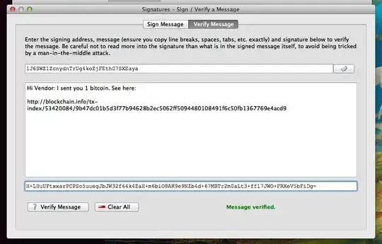

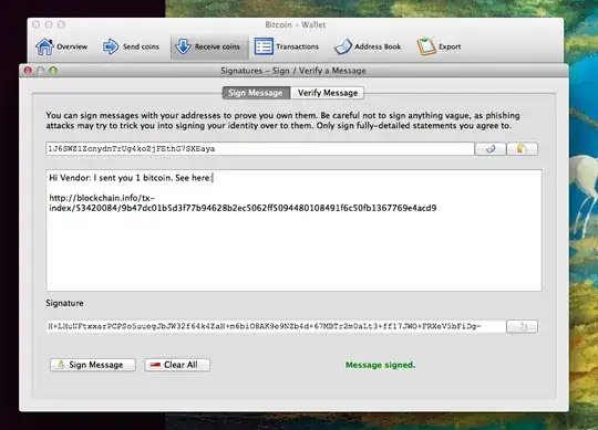

Using bitcoind and bitcoin-cli you can do it as follows:
bitcoin-cli signmessage 1DiWX6p3FdHPZqN88vMeGVXSwAQ1h7BeVj 'Hello world!'
In Bitcoin-qt
Or you can do it in blockchain.info/wallet by clicking the menu above your addresses.
No need to do it manually.
