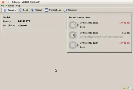

You can use testnet, it is a separate chain: https://en.bitcoin.it/wiki/Testnet

Can i create `bitcoins` without `mining`?. if not then how to mine `bitcoin` on `testnet` – suhailvs Nov 30 '13 at 07:37
There are bitcoin "faucets" for testnet bitcoins. http://tpfaucet.appspot.com/ – Karel Bílek Nov 30 '13 at 08:39
If you want to run `bitcoin`/`bitcoind` with testnet, just use `-testnet` flag. – Karel Bílek Nov 30 '13 at 08:54
@KarelBílek thank you very much for your help. but still i have `0.00` btc balance – suhailvs Nov 30 '13 at 09:16
@KarelBílek the link tpfaucet.appspot.com worked fine. thank you very much... :))) – suhailvs Nov 30 '13 at 09:42
