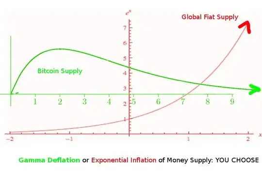

Every year 1% of people die.
If every year 1% of bitcoin is lost, every 70 years:
HALF the coins in circulation remain.
if all coins were accounted for and all were already mined:
2086 0.99^70  = 50% remain
2156 0.99^140 = 25% remain
2226 0.99^210 = 12.5% remain
2296 0.99^280 = 6.25% remain

  • Further, besides death and failure to will; there is house fire and paper wallets, and coins lost on hard drives that fail every 10 years unlike humans which tend to make it 70+ years, then there are coins lost because sent to invalid addy, and myriad of other failures. I suspect 1% annual loss of supply is conservative. http://i.imgur.com/6C238Pp.png – litepresence Jan 03 '17 at 21:00
  • No, I merely suggest that since Bitcoin is a young technology, it is adopted first mostly by 20-40 year olds, and that those age groups have a smaller portion of the dying population for decades to come. Also it seems rather absurd that with gaining importance and value people would continue to lose Bitcoin at the same rate, especially since backups of deterministic wallets (that have become more common since this question was asked) don't outdate and are thus are perfectly inheritable. – Murch Jan 03 '17 at 21:57
