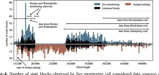

Update for everyone who stumbles up on this question. There is a paper that shows why it is hard to figure out the actual fork rate.
it's from this paper "Echoes of the Past: Recovering Blockchain Metrics From Merged Mining"

1It's worth adding that increases in block propagation speed (esp in the last 2.5 years) have further suppressed the propagation of stale blocks. Blocks which are stale before the source ever announced them don't propagate, so speeding up the network causes you to see fewer of them and things like BIP152 and fibre have made the network a lot faster. – G. Maxwell Feb 05 '19 at 22:50

- 31
- 3
You can see in the chart above that more recent times (e.g. post height 403200, 2016-03) look a lot different than 2014, however. – G. Maxwell Feb 06 '19 at 02:48
