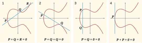

I'm reading up on ECC curves and on many of them I see an illustration that looks like this
What does the comparable curve in Bitcoin look like, or are all curves generally the same?

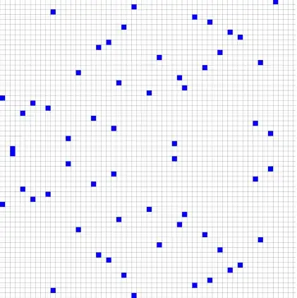

I've tried to plot this curve over a similar but much smaller field, Z28+1. Coordinates extend from -128 to 128.
y² = x³ + 7 over Z257, -128 through 128
Note that even though it may not make sense geometrically anymore, it still has all properties you need. A line (which means, a group of points with equation ay + bx + c = 0) that 'intersects' 2 points of the curve, will intersect a third. Tangent again has no geometric interpretation anymore, but you can still symbolically compute a derivative of the equation in a given point, which will have the property of intersecting the curve in a second point.
To show you what you'd get if this were over the real numbers, here is a plot of the same curve equation for that case. Once with coordinates -128 through 128, once with -8 through 8.

    @pieter you wrote: "that 'intersects' 2 points of the curve, will intersect a third.". Image 3 in the original post seems to show a vertical line intersecting at P + Q ... but seemingly not at a 3rd point. I'm just curious how is the "if 2 then 3" rule applied in ECC. – carl crott Sep 30 '17 at 22:56
    @carlcrott You're right - there is one exception, namely straight vertical lines intersect in only 2 points. This is solved by adding a virtual point 'at infinity' to the curve, which serves as neutral element. The result is a mathematical group. – Pieter Wuille Sep 30 '17 at 22:59

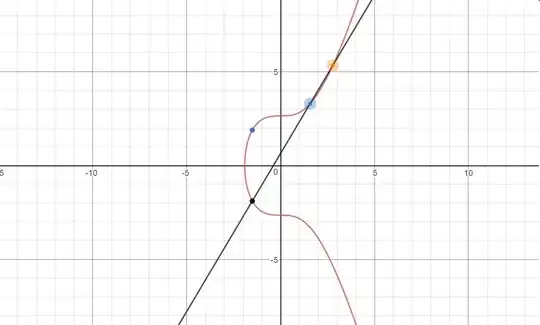

Below an illustration of the secp256k1's elliptic curve y2 = x3 + 7 over the real numbers (plot using www.desmos.com/calculator/ialhd71we3)
secp256k1 plot using www.desmos.com/calculator/ialhd71we3

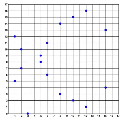

in the context of a finite field Zp, which greatly changes the ECC appearance but not its underlying equation or special properties. the picture below represents the same equation in a finite field F17 (the x and y values are integers between 0 and 17).
 Elliptic curve over F17

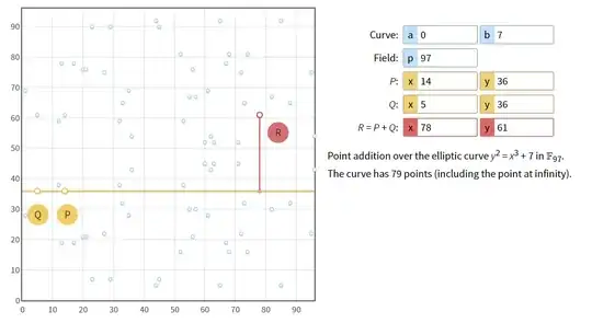

You will find an online opensource tool here https://cdn.rawgit.com/andreacorbellini/ecc/920b29a/interactive/modk-add.html which will help you to plot the graphe and to make addition or scalar multiplication on a EC. E.g plot over F97 with P+Q.

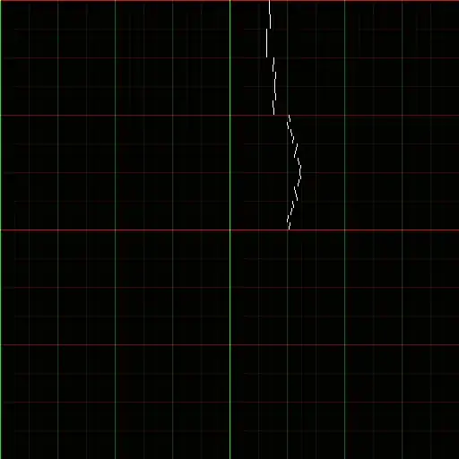

Since the underlying field for the elliptic curve for secp256k1 is Fp where p=2256-232-977, and since p is very close to a power of 2, it makes sense to try to graph the elliptic curve y2=x3+7 over the field of 2-adic numbers or related rings. Since we only have a finite amount of room to post here, let us simply graph the elliptic curve over a ring of the form Z2n. The ring of 2-adic integers is the inverse limit of the rings of the form Z2n. Therefore, the rings Z2n can be thought of as finite approximations for the ring of 2-adic integers. Now, we want to graph the elliptic curve in such a way so that two points which are near each other with respect to the 2-adic metric are also near each other on the graphical representation of the elliptic curve.
Let f:Z2n->{0,...,2n-1} be the function where f(a020+...+an-12n-1)= an-120+...+a02n-1 whenever a0,...,an-1 are all elements of the set {0,1}. In other words, f simply reverses the bits in the binary representation of an element of Z2n. Then the white pixels in the following graph are precisely at the points with coordinates (f(x),f(y)) where y2=x3+7 mod 2n where n=9. This picture is an approximation of the image of the elliptic curve over the ring of 2-adic integers.
Since the field of complex numbers is isomorphic to any ultraproduct of the algebraic closures of finite fields Fp by a non-principal ultrafilter on the set of all prime numbers, one should think of the finite fields as an approximation to the set of all complex numbers. Furthermore, the field of p-adic numbers embeds into the field of complex numbers, so one may think of the finite fields as objects that approximate a field that contains the field of p-adic numbers as a sub-field. Therefore, it is appropriate to use the graphs of the elliptic curve y2=x3+7 over the reals, complex numbers, or even the p-adic numbers as a visualization for the fields used in elliptic curve cryptography. One just needs to realize that one is working in a different field for visualization purposes.
